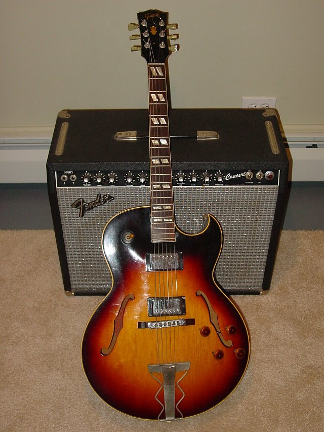

Howard's advice is right on. If anything ask the builder to take care of it.
At some point finish cracks are like old friends. For example, my 1960 ES175D:
